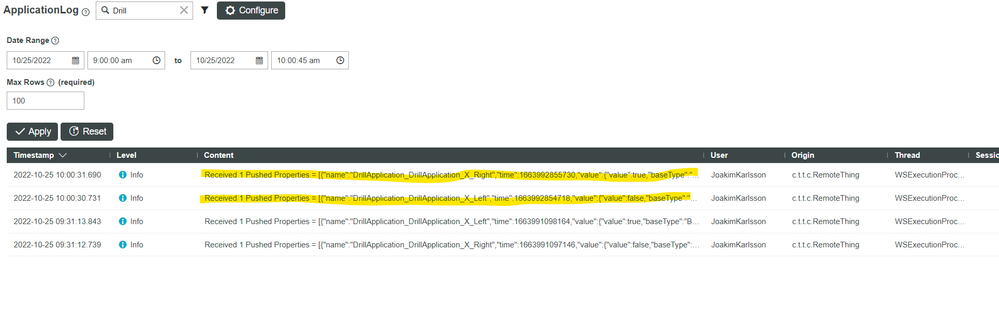

I have issues with thing properties bound to remote Kepware tags.
The Kepware tags are connected to OPC-UA endpoints and they all work and are updated as expected in the Quick OPC-UA client.
The Industrial Connection status is connected and the bound properties display as healthy. But when the Kepware values change, the properties are not updated. Refreshing the thing properties does nothing, but when I save the thing, then the values are updated.
The strange thing is this only happens on some bound tags and not all of them.
The applicationkey is created with the admin user for testing purposes right now.
Does anyone have similar experiences?
Regards JK

Have you bound the same tag to multiple properties?
What are your advanced settings on the bindings? push/pull/expiration?
I think the problem appears when I pick tags originated from different plc:s in Kepware and assign them to properties in the same thing. But the selected tags are not bound to properties on any other things in Thingworx.
The values are set to be pushed on value change.

Sure that could be related, but I do have entries Performed==Queued.
Also I can see in the log the datachange, but refreshing the thing does not update the property values, only if I click save. Still datachange events do not trigger.

After changing the property setting "Cache Method" to "Fetch from remote every read", the values updates as expected.
The resolution suggested in:
https://www.ptc.com/en/support/article/cs316645
