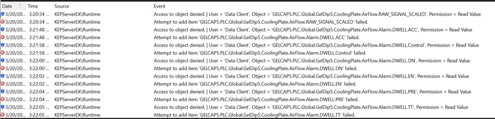

acess to object denied in kepware issue
RS_13132666
2-Explorer
could you please let me know how to relsolve issue.

Not able to access article.
Article Number
000436864
Title
Error "Access to object denied. | User = 'Data Client', Object = Channel.Device.Tag, Permission = Read Value" in PTC Kepware Products
Description
  • User can not see any tag on Quick Client
  • Getting error

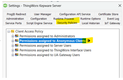

Additional Context
Cause
  • Permissions are denied
Resolution
  • Go to  the Administration Utility > Settings > User Manager > Anonymous Clients >  I/O Tag Access
    • Set Read/Write Value = Allow
OR
  • Check the security policy under Administration Utility > Settings >Security Policies>Permission Assigned to Anonymous Clients and clear the saved one
  • Note- Someone might have configured this for safety, so it is suggested to check with your team
