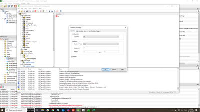

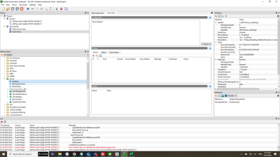

I add a area and source to validate Alarm and Event funciton with UAExpert
A/E should be activated as well
But in UAExpert, I can't see it and I can't find any access to see it, please give me a help here, thanks
AE is not currently supported over UA, please see the following article:
https://www.ptc.com/en/support/article/CS385019
-Andy
