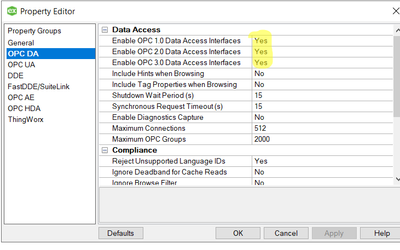

Hi
Have the same 800040002 error in quick client, Resolution is enable OPC DA
BR, Krzysiek
