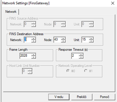

Dear Experts,
We have several controllers on the network and we would like to collect data from them in parallel, so that we keep the Omron scada intact. The controllers are of type CJ2.
We are testing with the trial version of KepserverEX 6 and for now we are testing the connection with only one controller.
The controller data is as follows:
Fins destination address
IP: 10.0.0.43
Network: 3
node: 43
unit:15
frame Length: 2028
The error is as follows:
Date Time Level Source Event
10.07.2025 09:57:03 Warning Omron FINS Ethernet Omron.ABC3 | Device responded with network relay error. | Net address = 003, Node address = 043, Main error = 0X10, Sub error = 0X5, End code = 0X9005.
I also tested the connection directly to the PLC (disconnected the connection to the SCADA system) and we had the same error.
What did we set wrong?
Thank you and best regards
Hi.
Setting Value
Source Network 0
Source Node 10 (or 100)
Destination Network 3
Destination Node 43
Destination Unit 15
Frame Length 2028
Response Timeout 2s
Try that, then reinitiate the connection.
