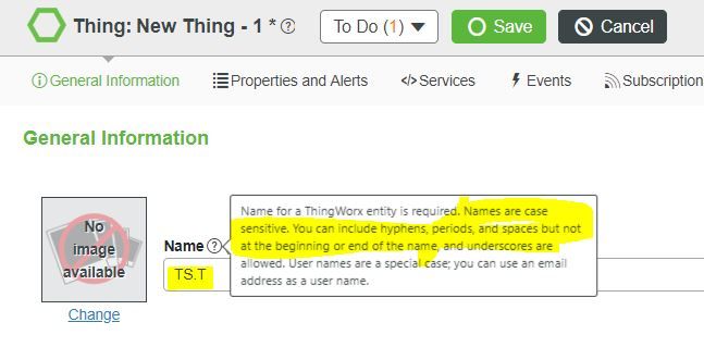

Hi @RagnarRoestad ,
Dot is allowed in between name but not at the beginning or end of the name. PFB screenshot for reference.

Hi @RagnarRoestad ,
