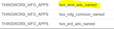

mnaeem
(To:slangley)
Thank You @slangley!
Here is the screen shot of Licensing Subsystem Settings.
Best Regards,
Naeem
slangley
23-Emerald II
(To:mnaeem)
It looks like your license file is missing one of the Mfg Apps features:
At this point, it's best to open a case.  I will be happy to open one on your behalf with your approval to do so.
