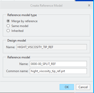

Can MBD/annotations be translated (copied) over from the design model to the mold_ref model?
When we assemble the design model into the mold assembly; you have three choices, 1)  Merge by reference, 2) Same model, 3) Inherited.
We have always used the Merge by reference option.
So ultimately, I’m asking if GTOL/Annotations be transferred to a External Merge feature (part)?
if you used inherited and annotations, parameters will continue to be visible.
