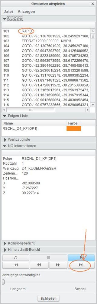

Slower than to the very left is not possible (not that I know of).
But you can go through the program step by step klicking to the encircled button at the bottom right.
And remember: The Rapid moves are done instantly. You can not see them. See the encircled RAPID at the cl-data window.
BIG P.S.:
What I use is the material removal. It runs slower.
If you just look at the path, you can use that tool path simulation becaue it runs so fast.
if you want a HUUGE slowdown, activate the WIREFRAME view.
The framerate drops very much. THIS WILL HELP YOU!
