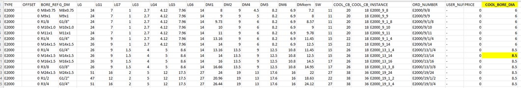

Hello everyone. I need to change the default diameter in the creation of the water circuit in EMX, in the options there is the entry WATERLINE_DESIGNER_DEFAULT_COMPONENT set like this:
mm | meusburger | E2080_8_10 && mm | meusburger | E2000_13_14 && mm | meusburger | E2130_11_8_2_4 && mm | meusburger | HOLE_8, where I assume that HOLE_8 is an instance present in the HOLE.dat file, I should bring the default value to 8.5, in the file HOLE.dat I inserted a line with the name of the instance HOLE_8_5 but changing the options mm | meusburger | E2080_8_10 && mm | meusburger | E2000_13_14 && mm | meusburger | E2130_11_8_2_4 && mm | meusburger | HOLE_8_5 when I launch the creation of the circuit it always remains Ø8, something wrong?

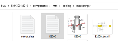

Hai,
you can add one separate column for  meusburger Dat file in below location. So that it will work as a wild card entry.
refer below example.
Please let me know if required further clarity.
