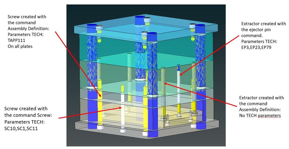

gcambiaghi
(To:tschneyer)
Why are the screw holes created in the plates used different to those created when inserting a screw as a component?
I ask you this because I need the customer to color the thread pre-hole with the screw seat differently.
See attachment
gcambiaghi
(To:tschneyer)
I have noticed that the UDFs which generate the holes by means of the assembly definition are different from the UDFs generated by the special commands Screws, Extractors, Bushes, Columns. Is there a reason for this? I ask this question because I have to configure all the colours for a customer, keeping the precise locations and the tolerated locations for recognition separate.Colori.JPG
