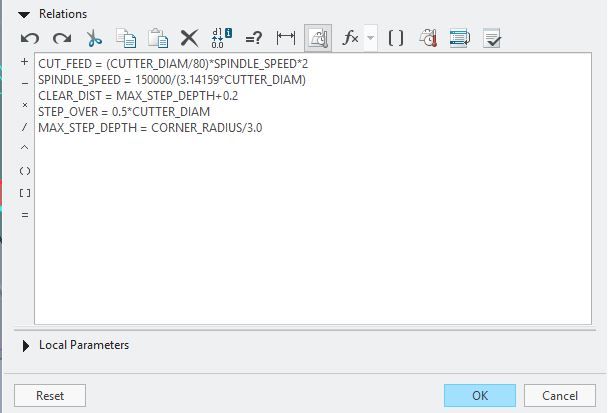

Has anyone figured out how to modify the default relations that auto populate sequence parameters yet?
Looks like site files are  the answer.

How do you adjust for different materials ? or do you not change say for going from steel to aluminum.
I suppose you could have site files based on machine and material parameters.
We have dedicated task machines so I am interested in machine specific settitngs. I was more just annoyed with the auto population of settings 120k rpm was not going to work!
