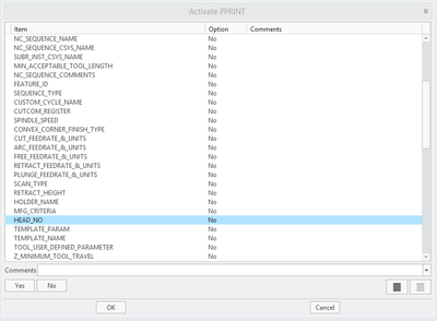

I was utilizing the HEAD word to pull up a macro in IMSpost to output probing strings and variable prompts. It is no longer being output in the ncl for Creo Parametric 4.0. Any ideas how to force this back out?
Creo 2.0
PPRINT /
PPRINT / OPERATION CSYS NAME : MACH_CSYS
HEAD / 1
PPRINT / NC SEQUENCE NAME : B270_6IN_TANG_G56
Creo 4.0
PPRINT /     26        T0026      1      4-750_OD_BORING_HEAD
PPRINT / OPERATION CSYS NAME : NC_ASM_DEF_CSYS
PPRINT / NC SEQUENCE NAME : B270_3IN_F-MILL_G57
I tried a few things, but the best way to get cl data out as I did with Creo Parametric 2.0 was to create HEAD.ncl, and put HEAD / 1 in the file. Then I call it up in PRE_MACHINING_FILE in the 1st nc sequence to get the ncl file the same as before.

Did you check your PPrint table if HEAD_NO option is set to yes.

but when I change HEAD_NO to Yes in the PPRINT, I get :
PPRINT / HEAD_NO : N/A
I need the CL word to trigger a macro in my post.
Thanks for helping to look for a resolution.
I suspect that your work center type is set to "Milling"
To get head number display correctly the work center type need to be "Mill/Turn" or "Lathe"
In Creo 2 it was putting it in the ncl when set to Milling. What changed in Creo 4?
