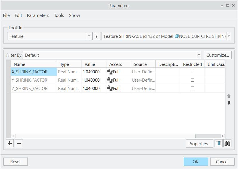

Does anyone know how, or if it's possible, to extract the shrinkage value from a part, as a parameter?  This has to be stored as a system parameter value somewhere in the model.  I'd like to be able to show the general shrinkage value on our prints.

Parameters for Shrinkage are  X_SHRINK_FACTOR/ Y_SHRINK_FACTOR/ Z_SHRINK_FACTOR and these are feature level parameters.
I think Article CS153684 ​​​​​​​can help you.

Use Tools-> Parameters to open the parameter editor.
Set the Look in option to feature and select the shrink feature
This will display the feature parameters for the shrink feature that can be used in relations, notes, etc.
