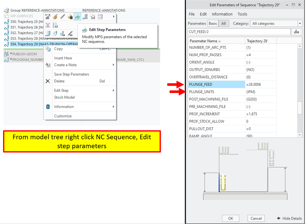

the values are driven by the NC sequence parameter value
Thank you for answer, BryantMorgan!
But where did the values for PLUNGE_FEED (=2.4) and PLUNGE_UNITS (=IPM) come from (in your drawing) ?
At what stage were these variables assigned to PLUNGE_FEED and PLUNGE_UNITS?
Explain, please!

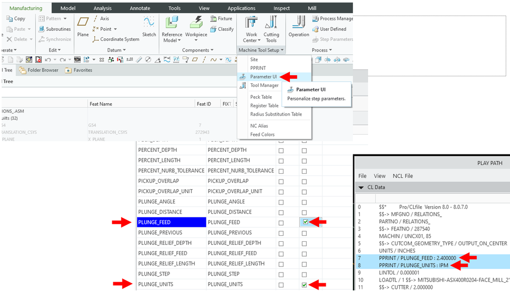

You can also add columns to your model tree for each of the parameters and change parameters via the model tree.
I do not know of a way (or reason you would want to) break the link between the NC Sequence parameter and a PPRINT value.

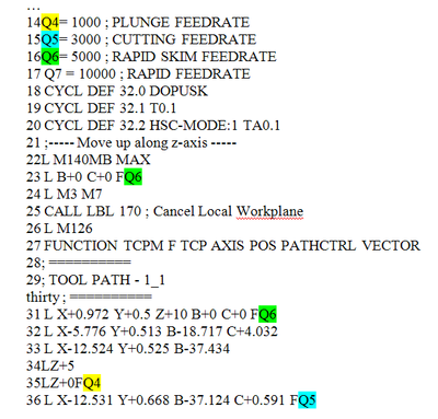

 I want to declare NC control parameters of feeds in the postprocessor at the beginning of the CNC program (type #1, #2, etc). And then refer to them:
G01 XYZF#1 or G01 XYZF#2. And in the postprocessor, catch all the feeds from the parameters ... Something like this ...

BryantMorgan
(To:sstavruk)
PLUNGE_FEED (= 2.4)
The parenthesis indicate it is a value driven by a higher level.
In this case a SITE file has a relation and is calculating the PLUNGE_FEED I believe the SITE file says "PLUNGE_FEED = CUT_FEED/5"
The SITE file can be used to set the default value for NC sequence parameters.
Sorry I didn't explain this in an earlier reply.
This was the question: is it possible to assign these PPRINTs if there are no feedrate values ​​corresponding to them in the NC sequence: No, for example, the parameter PLUNGE FEEDRATE in the NC sequence. So PPRINT PLUNGE FEEDRATE & UNITS is empty. In this case, I force it in the postprocessor:
Q4 = 1000 ; PLUNGE FEEDRATE.

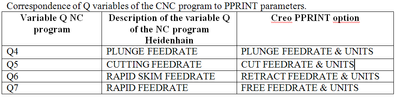

In the GPOST postprocessor, I made the following functionality:
For quick editing of feeds on the machine in continuous 5-axis milling mode, the feed values ​​are assigned using the parameters at the beginning of the program:
For example:
To use the parameters, it is necessary to have in the CREO PPRINT session for submissions:
CUT FEEDRATE & UNITS
RETRACT FEEDRATE & UNITS
FREE FEEDRATE & UNITS
In case no such PPRINTs are assigned to the session, the following PPRINT values ​​are set by default:
$$ Variable initialization in case there is no PPRINT:
Q4 = 1000 $$ PLUNGE FEEDRATE
Q5 = 3000 $$ CUTTING FEEDRATE
Q6 = 5000 $$ RAPID SKIM FEEDRATE
Q7 = 10000 $$ RAPID FEEDRATE
If PPRINT is set, then their values ​​are read and assigned to rack variables Q(4,5,6,7).
Values of PPRINTs assigned ONLY from NC sequence parameters!
