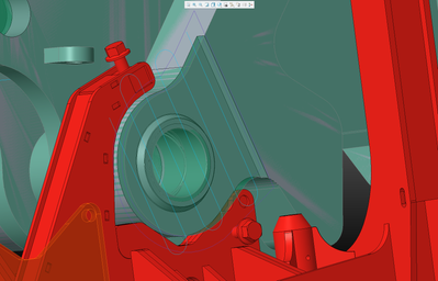

I have always struggled with Creo when it comes to getting good millpaths.  No matter what I try, it always seems like Creo defaults to pushing the cutter directly into the middle of the part (material fully surrounding the cutter) instead of slowly milling its way into the part from the outside in.
I have dealt with this issue for many years now, and decided it's time to make a post here asking for help.  As you can see in the video, it would be ideal to mill the outside first, allowing 2/3rds of the cutter in the material until it mills completely to the center.

Can you send the sequence parameters?
try SCAN_TYPE to CONSTANT_LOAD
The best solution is to use the HIGH SPEED MILLING option

I tried CONSTANT_LOAD and every other SCAN_TYPE with the same results.  This has been an ongoing issue for a very long time now where we fumble our way through Creo toggling every option on or off, then adjusting the mill window just a hair until finally by absolute luck, we get somewhat of a workable toolpath, albeit still with issues that we cannot control.

What type of sequence are you using?  In Volume Rough, you could try "Cut Direction - Reverse" if you have not already done that.  For the most part, I don't see any issues with sending this type of cutter to the middle of the material and letting it work itself to the outside, but I do know of a few paths on things we do that we use the reverse cut direction.

I am using  Volume Rough.  Thanks for the "Cut Direction - Reverse" suggestion, as I was not aware of that parameter, and it does get the toolpath much closer to what I would consider ideal.  The issue with sending a face mill to the center of the part is chatter.  That ensures the full diameter is completely surrounded by material on all sides, when it is much better to use 2/3rds of the cutter to remove material for less chatter.

An Ideal toolpath (Until it got down to the chamfer area) would be something like this  which uses 2/3rds of the cutter per pass, but I would like to get Creo to do this without me having to manually sketch it out and then using a trajectory pass.  I would like the software to work for me.
