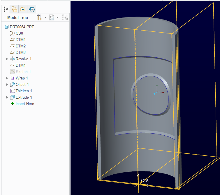

I need to extrude a wrapped sketch - not text if that matters
It's on the inside of a cylinder - not the outside.
It will be a mold, get it? the inside will be the outside of the part - derp.
Any suggestions? I've had no success whatsoever or I would not be asking.
Vince
Apr 27, 2016 10:19 PM UTC
I've attached a Creo 3 commercial version file using the basic technique for Offset.
Notice the relation in the main offset sketch to account for circumference.
When using Wrap, remember to put a coordinate system in the sketch and have the wrap follow that rather than center.
See the Offset feature options to understand how the projection (extrusion) is behaving.
Notice that the sketch has to be planar.  This is okay as you can simply project back the curves from the wrap.  In order to preserve accuracy, this is one way to do this.
What is different from a normal extrude is that it can reference the surface curvature to determine the connecting sidewalls.
If you were trying to place features all around, you may need to make multiple features in different directions.
Another technique can use sheetmetal to create a flat pattern extrude and then bend-back the cylinder.
And finally, similar to sheetmetal, you can use spinal bend to make the part flat and then roll it up.
As with all things Creo, there is no right answer.  Any solution is highly dependent on the task at hand at that moment.

How far does it wrap around the cylinder? Do you plan to pull it all in one direction? Any images you could load would be helpful.
Apr 27, 2016 9:12 PM UTC
No need to wrap the sketch (maybe*), that's good for cosmetic curves on surfaces and other surface modeling techniques. Try the Offset tool, instead:
  1. Select your surface, the go to Model>Editing>Offset.
  2. In the drop-down box with icons, pick "With Draft Feature".
  3. In Reference tab, select your sketch or create sketch on-the-fly.
  4. The rest is choosing dimensions and picking your side surface options.
*Wrapping the sketch will keep its height and width the same as the original sketch. If that's needed it can be achieved with surface modeling.
*Offset will stretch the sketch; from a normal view the original sketch and extrusion will have the same perimeter.
Apr 27, 2016 9:33 PM UTC
That's what I ended up doing but the great question remains can I create this with a wrapped feature so it isn't distorted.
Apr 27, 2016 9:42 PM UTC
In general, this is a complex process in many cases but yes, you can begin with a wrap to preserve the design intent.
The direction of the extrude is also important but those options are included in the offset feature.
Offset also allows you to add draft.
Can you share an image of what level of complexity this part exhibits?
