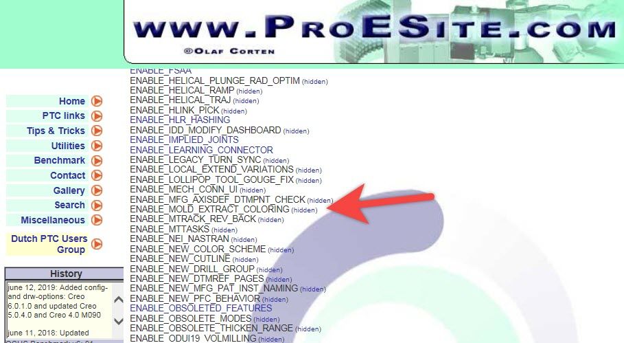

Sorry, I didn't mention that it's a hidden option.  You will have to enter it manually in your config.pro using a text editor.coloring.jpg

Try setting the config.pro option, enable_mold_extract_coloring to NO.  By default, it is set to yes.  This worked for my company.
This may not work on existing mold splits, but should work on new ones.  I wonder if PTC internally tags those surfaces during the split creation, which cannot be over-road by the config.pro setting.
I cannot find that option in my config editor. I am currently using Creo 4, maybe this is an option in later versions. I will check this option after my company updates our version.
Well I have added this option to my config file. I will update this post soon if this turns out to be what I am looking for.
