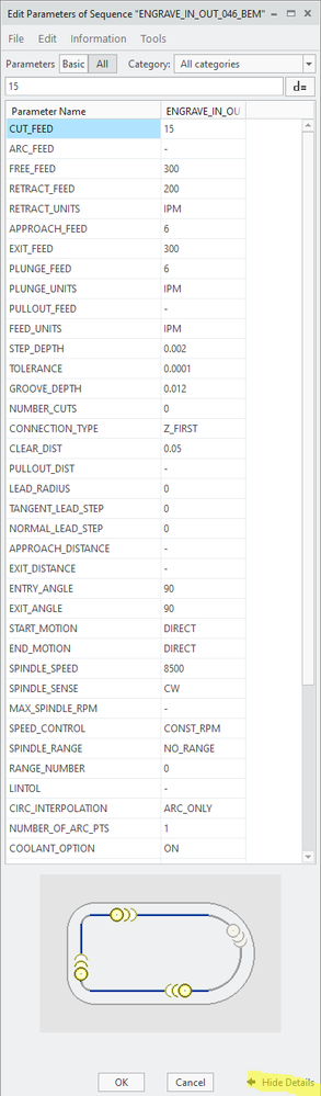

Hi folks,
In Creo NC, using Machine Tool Setup -> Parameter UI, I have edited the list of basic parameters visible in the "Parameters" list of NC sequence edition.
Because it's quite a long list of basic parameters that I now have, I'm wondering if it's possible to customize the default size of the "Parameters" dropdown window in order to extend it downwards. See attached screenshot for visual.
I prefer having a tall "Parameters" dropdown window rather than having to scroll the list to see all my basic parameters at once.
Any pointers much appreciated.

@JackBender
As of now no option to expand the list.. you need to use "Edit Step parameters" to pullout the parameters list.
I think, you can submit an idea for the same.
I would like to see the parameter list expanded automatically even when you do use the "edit step parameter" method. I would also like to be able to hide the "details" check box permanently. After using the sequence more than once or twice the details become a nuisance taking up parameter space
Personally, I don't like looking at the long list so I use the Category filter in the upper right most of the time.
I would also love to have this.
I modified the parameter
"mfg_comments_text_area_size" to a higher number, but here is no change.
Daniel_E
6-Contributor
(To:hheinze)
+1 for this option.  I would also love it.  And I would love to change the default position of the window.
