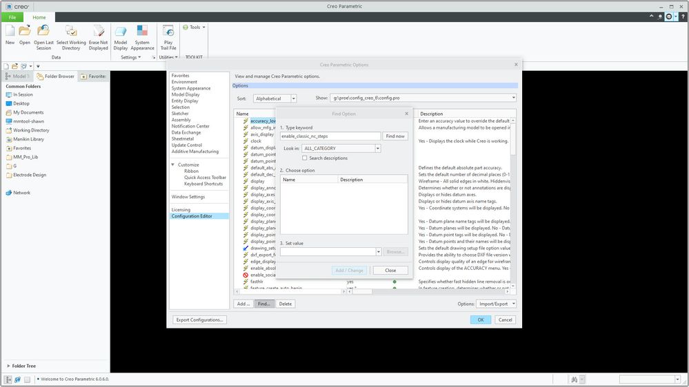

I just put enable_classic_nc_steps in the find now box on the config editor of Creo 6 and nothing comes up.  Am I missing something hereno enable_classic_nc_step config option.jpg
enable_classic_nc_steps option is hidden. If I were you I would open config.pro in Notepad and add the option at the end of the file. Creo restart is needed.
