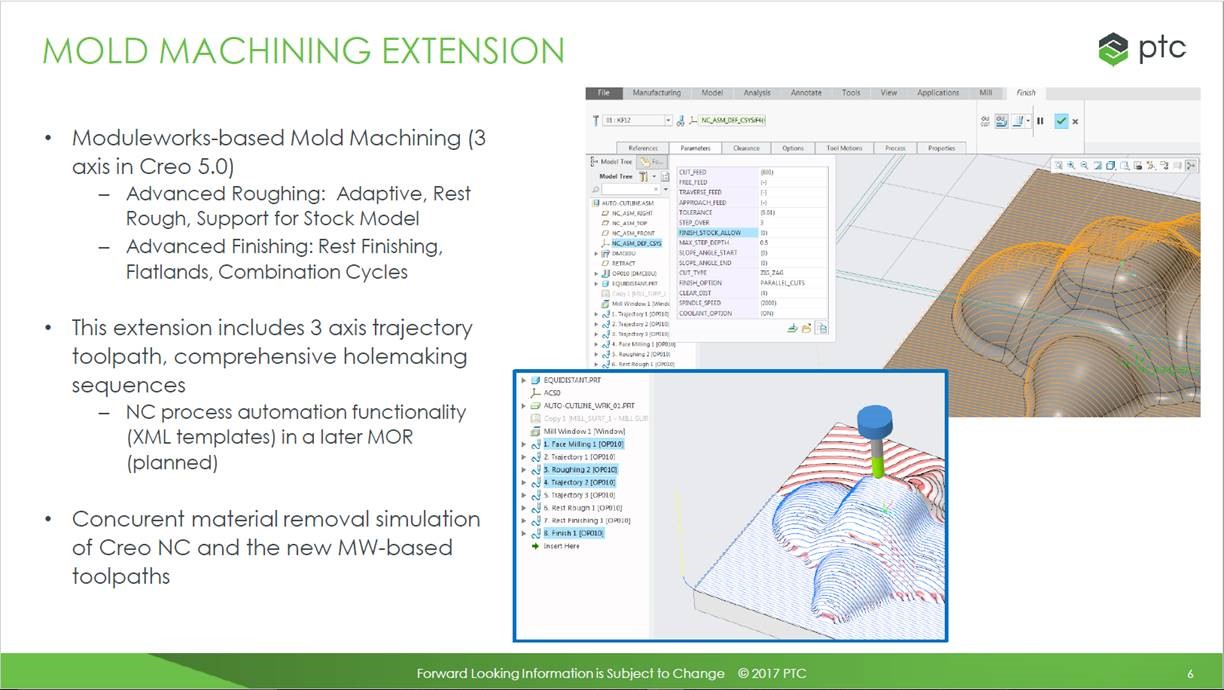

From what I understand, Creo Mold Machining Extension is it's own license so you would have to purchase this in order to use it.  It is built by ModuleWorks and there is very little information about what parts of 3-Axis ModuleWorks are included.  It is being promoted to the mold industry (hence the name) as an "easier to learn" product with more options for 3D high speed machining than what NC has to offer.  XML templates are a future enhancement so I suspect there is no template capability with the product as it stands today.  I haven't seen much more than what is in the images below. creo-mmx1.jpgcreo-mmx2.jpg

I work in a small mold shop and I personally am really sad to see that PTC has decided to "buy" this technology rather than fix or enhance what they already have. I for one will not be purchasing an additional addon package for mold machining just for the latest HSM technology.
We went down this road before with the ProToolmaker package a few years ago. That was a real mess that never worked as advertised. I hope this package work better for whoever can afford and wants to buy and maintain more software
