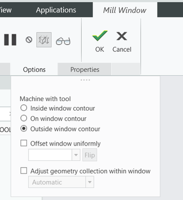

Hello, I have a question about restricting the tool within the milling window in high-speed machining (HSM), similar to volume milling. I would be very thankful if someone could share any sample files of HSM.

Daniel_E
(To:asifcad)

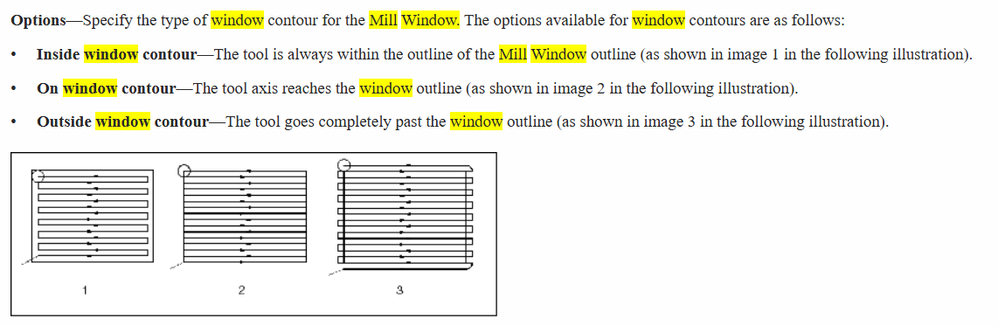

Check your Allow_entry_outside parameter on your HSM step:
  • If you have this parameter set to yes, then the mill window settings (outside, on, inside) are basically ignored, and the tool movement is seemingly unrestricted.
  • If you have this parameter set to no, then the tool will be restricted as you would expect from your mill window choice.
From the help files:
