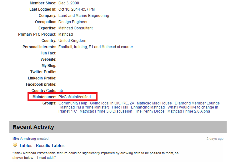

Mike,
It seem's that now you have a maintenance rights ?
MikeArmstrong
How, why, when?? 🙂

VladimirN. wrote:
Mike,
Or the idea section has been opened to all

Mike Armstrong wrote:
How, why, when?? 🙂
Your status is changed:
MikeArmstrong
How, why, when?? 🙂
Very strange indeed. I am positive that this has been changed recently.
