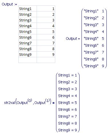

OK. We are (i.e. I am) getting confused here. There are two requests: variable name to string, and string to variable name (i.e. create a variable based on a string). You want variable name to string. I see the utility of that. Wayne asked for string to variable name, and that's the one where I don't see how it would be used in practice.
MikeArmstrong
Oh right.
The function I requested wouldn't be top of my most wanted functions, but would defiantly be included in an ideal world.
The string to variable function might be useful if data is being brough in to Mathcad. If reactions had been calculated for a pin joint system and they where brought is a string. I haven't had this problem myself, but can see where it might be needed.

AlanStevens
Suppose you import an Excel file that has, say a whole load of variable names/descriptors in one column and the corresponding numerical values in the adjacent column. Then it might be useful to keep the same names in Mathcad, and, instead of rewriting them it could be useful simply to write something like
str2var(data<0>,data<1>) or str2var(data<0>):=data<1> (where I've assumed the relevant Excel information has been read into the first two columns of Mathcad variable, data.
Alan
RichardJ
But unless you know what the string in data<0> will be when you write the worksheet the variable will not be used for anything, because it's not referenced anywhere in the worksheet. And if you do know what the string in data<0> will be, say MyVar, then you could just write MyVar:=data<1> when you create the worksheet.

I get Wayne's point now. Maybe something like below.
Mike
RichardJ
But you would have to know that the variable names would be string1, string2, etc, or you couldn't use them for anything later in the worksheet. So you could just write:
Granted, that is more typing (Stuart's argument), but unless the number of variables is really large that doesn;t make too much difference.
