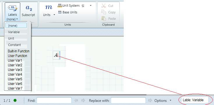

It will be good to have in Mathcad Prime not only built-in labels (see here) but users labels too - as in normal Mathcad: Var1, Var2...

Can you describe more what you'd like. We have added math formatting to Mathcad Prime 3.0, but didn't extend labels. Are you suggesting we have labels for vectors, matrices, and user labels?

I would like to have 7 (a fine number!) users lables and use it for vectors, matrices, invisible variables etc what I would like! See my original post!

I will be happy to have so:
