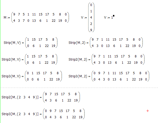

BTW Mike, you have an error in your worksheet: your expression says Strip2(M,3), not Strip3(M,2).

Werner Exinger wrote:
Thanks, that old thread transforms slowly into a contest
Not a contest I was just bored.
Using a local variable O instead of ORIGIN seems to be a matter of taste. I am used to it from longer programs as I find the O (reminds me of a zero) makes the lines shorter and provides better readability compared to the lenghty ORIGIN. Very often I don't bother making my routines ORIGIN-aware as I never change ORIGIN in my sheets.
It does look neater I give you that. I just don't like it defined at the start of every program.
I don't agree with the omission of the initialisation of the local variable OUT. I feel thats it a bug of Mathcad that its doesn't throw an error if the variable is used (cols(OUT)) without any initialisation. you may also run into troubles if there exists a worksheet variable OUT which is already a vector.
Mathcad allows the usage of OUT w/o initialisation because OUT is assigned in a for-loop. I commented on this behaviour about a week ago - http://communities.ptc.com/message/233148#233148
Valid point. I have seem this cause problems in the past - sorry just being lazy.
MikeArmstrong
Typo oops....
