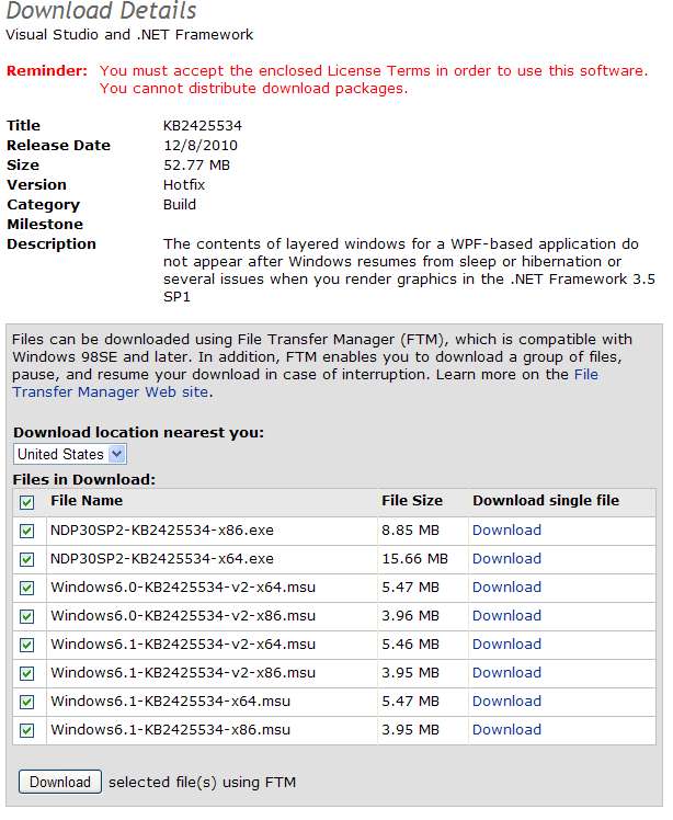

After being very frustrated with Prime 1.0's performance, I found this thread. When I go to the MS page, there are 8 files listed to download and no real instructions on what to do with them. I assume I only need 1 or 2 of them depending on my operating system but that's a bit cryptic. Do you know which files are for what or do I actually need them all?
Thanx
Tony

Thanx for the response. I have those instructions, which are pretty complete. The issue is the instructions on Microsoft's page. Below is a screen shot of the page. There are 8 files here and no real instructions for how to apply the patch. Do I need to install all of these or just 1 or 2??? It looks as though there are different ones for each operating system but its pretty cryptic.
A.DelNegro
Ok, I downloaded them all. I didn't notice till I looked in the folder that only 2 of them are .exe files so I just ran the one matching my system. Hopefully this will work.
Thanx
T

Anthony,
One of them is for Windows 32-bit ("...x86.exe") and the other one for 64-bit ("...x64.exe").
