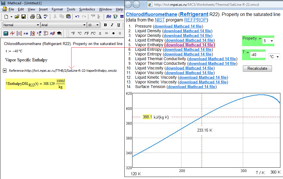

I have a lot of files for Mathcad with functions of thermophysical properties of substans.
Users of my server can:buil-in
a) Do on-line calculation by help the Mathcad Server - one example http://twt.mpei.ac.ru/MCS/Worksheets/Thermal/SatLine-R-22.xmcd
b) Download this functions (for Mathcad 15 and partly for Mathcad Prime) - one example http://twt.mpei.ac.ru/MCS/Worksheets/Thermal/SatLine-R-12.xmcd
c) Do references on this function - see the picture.
d) Use DLL for have some this function as a buil-in ffunction - see www.wps.ru
If PTC has a wish we can do colmplate this work and provide Mathcad users this functions and examples with using this functions.

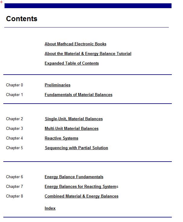

Thanks for the info Vladimir. I went to that site but I couldn't tell what was actually in the ebook. So before I download a 2+ MB file, can you tell me if it has a database of compounds with properties that include vapor/liquid/liquid equilibrium (VLLE) interaction coefficients?
Harvey
VladimirN
24-Ruby I
No, I didn't see such database in the e-book. The content of this Mathcad e-book:
