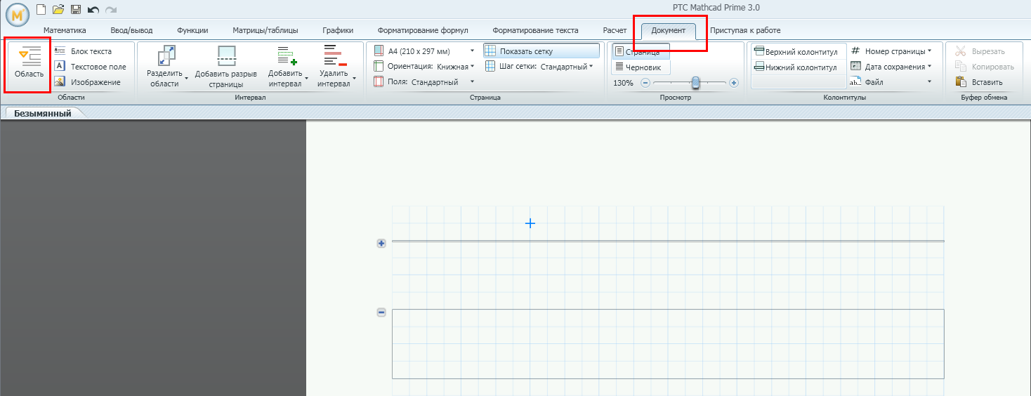

You can insert "Collapsible Area" (in main menu select "Document" -> "Area"):

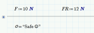

We had more possibilities to do what you demand with Mathcad 15 (symbolic eval with hidden left hand side; user defined styles like white on white; scripted text boxes,..) but the only solution in Prime I can think of is to assign the result to a variable (in a collapsed area, as Vladimir suggested; unlike in MC15 we cannot hide the area completely) and evaluate that variable below.
