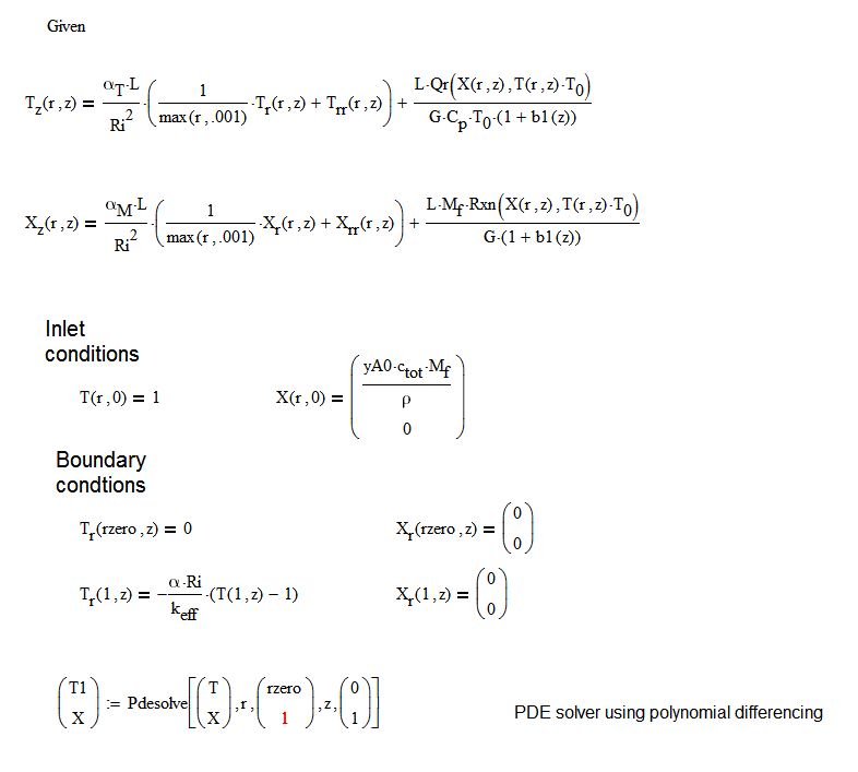

The snip below shows an example of how pdesolve should work. Note that X is a vector, but the indexes are never used in the equations in the solve block so they don't interfere with the literal subscripts used for the derivatives. The indexes of X are used in the definition of Rxn and Qr functions however. Rxn is also a vector function with the same number of elements as X vector.
The dimensions of T and X are defined by the initial and boundary conditions, there shouldn't be a need for explicitly defining these dimensions (i.e. number of elements).
This method should be able to handle many problems. There still may be problems that need to explicitly refer to the elements of the dependent variables, but having the above capability would be a big help. This is not a huge change (it seems to me) from the current solver. It just requires the ability to recognize a vector equation with a vector dependent variable.

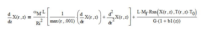

Another option:
Instead of the literal subscripts for the independent variables for the derivatives,
It seems to me if this form were used, we should also be able to use subscripted variables explicitly in the equation.
