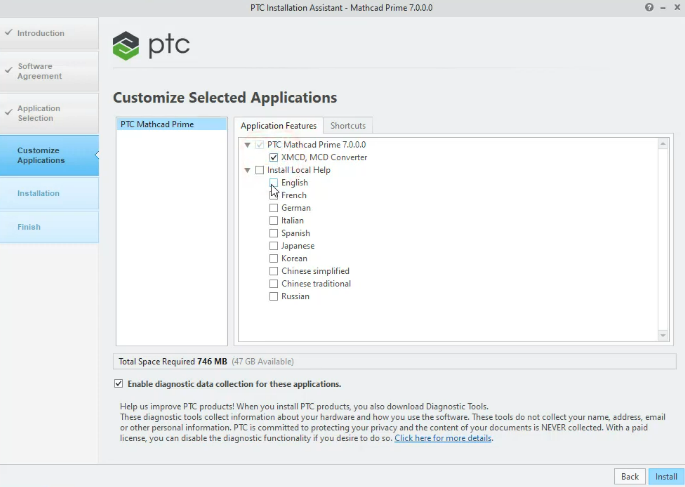

I have installed the MathCad 8.0 Prime trial version. However, when I navigate to Input/Output tab, the XMCD, MCD tab is under intensified. I cannot convert files from an older version. The license file states it is a fully functional license. How to enable convertions.
Starting from the 7th version of Mathcad Prime you can use the built-in converter (before the installation process, it is necessary to select it among the installation components).
Thanks!  That fixed it for me......
