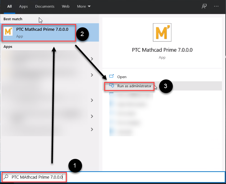

1. Run LicenseWizard.exe from default location C:\Program Files\PTC\Mathcad Prime X.0.0.0  ( Mathcad Prime 7.0.0.0  - 8.0.0.0 ) or Launch using Windows #Search and #Run as administrator

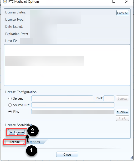

2.  Select Mathcad Icon M' and then select #M' Options
Select option #License

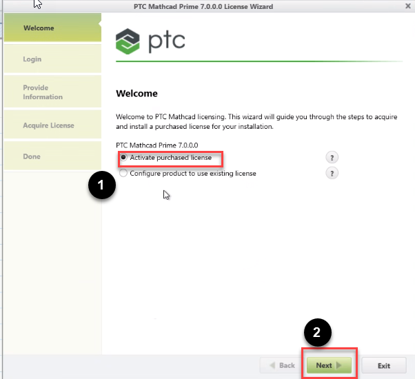

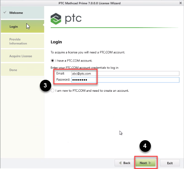

3.  Follow the Steps as highlighted in numerically ascending order and select #Next

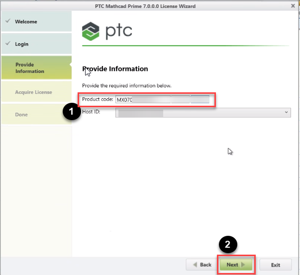

4. Enter the Product Code, #Next on Acquire License Page check the product for which the license needs to be activated  and select #Acquire License (4)
