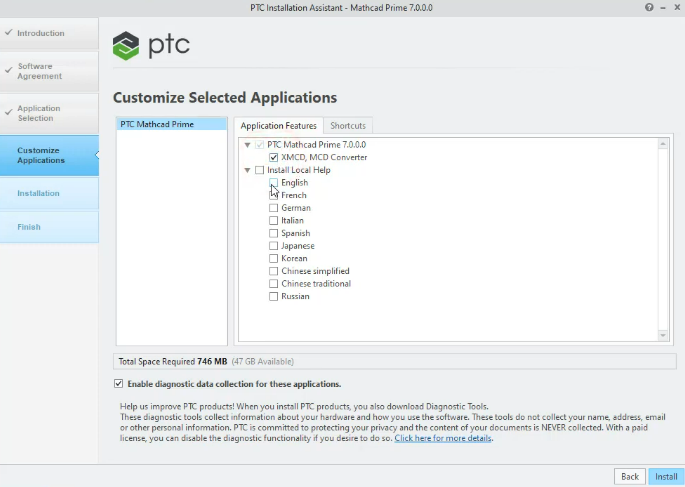

I Just bought Mathcad prime 8 because I need to open old files in .mcd format but the mcd converter is not active. what Can I do because it seems that I need Mathcad 15 and I don't have it.

Starting from the 7th version of Mathcad Prime you can use the built-in converter (before the installation process, it is necessary to select it among the installation components).

You don't need Mathcad 15 (anymore with Prime 7 or 8).
You need to rerun the installation for Prime 8 and tick to also install the converter.
