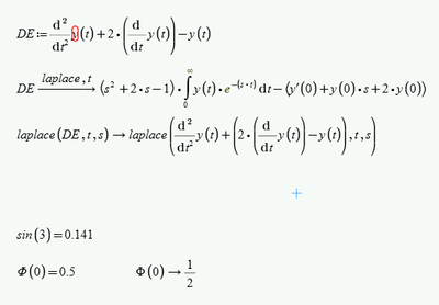

Apart from converting the .MCD files to .MCDX files, Prime 8, while in full mode will also allow to create an html file of your Mathcad 11 sheet, showing the calculation results for the numerical calculations as performed by Prime (NOT those by Mathcad 11) as demonstrated by
This Mathcad 11 file:
Results in this html output by Prime 8's built in converter:
Notice:
1. NO symbolic results. You should also realise that the symbolic engine of Prime8 is completely different from that of Mathcad 11.
2. Numerical results according to Prime's numerical processor (Mathcad 11's numerical result of the Heaviside step function at 0 is 1, while Prime sets it to 1/2).
Once converted to Prime8 and encouraged to finally calculate the symbolic results, this comes up:
Prime doesn't know the laplace() function (which is an undocumented feature of Mathcad 11).

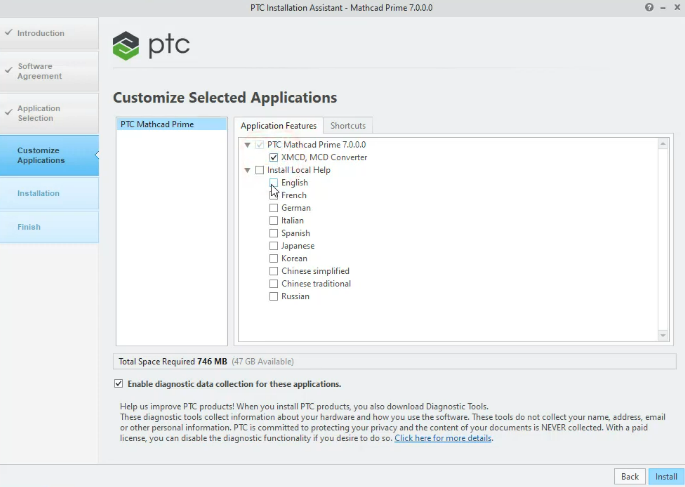

Starting from the 7th version of Mathcad Prime you can use the built-in converter (before the installation process, it is necessary to select it among the installation components).
