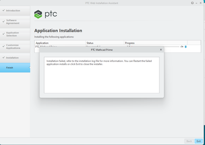

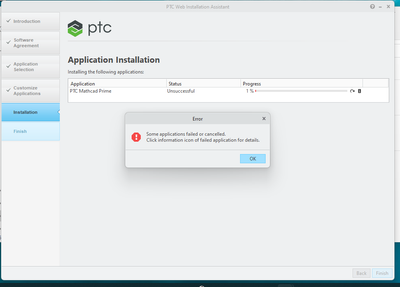

The software is not installing. It is showing the following error in the installation: "Some applications failed or cancelled. Click Information of failed application for details. " ; "Installation failed, refer to the installation log file for more information. You can Restart the application installs or click Exit to close the installer.";
How to install?

1. Qual versão do programa você está tentando instalar?
2. Mostre uma captura de tela do erro que ocorre.

Try the following:
  • First run "pim_installmgr_mathcad.exe" and when it gives "Error at 1%" after downloading files,
  • Go the path (in Windows 10): C:\Users\YourUsername\AppData\Roaming\PTC Download\MED-XXX-XX-XXX_X-X-X-X\ptcsh0\ ,
  • run "PrimeWixInstaller_64bit.msi" installation file.
P.S. And one more tip: https://community.ptc.com/t5/PTC-Mathcad-Installation/Error-quot-PTC-Installation-Assistant-has-stopped-working-quot/m-p/706416#M21
