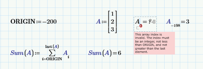

In short: Don't change ORIGIN in a worksheet. You normally should use it. E.g. to sum all values of an array, use:
This will let the index i run from the first index (no matter what the setting of ORIGIN is, it can be 0, 1  or -200) to the last index. as shown here:
Now if you change ORIGIN to any (other, integer) value , Sum(A) will still produce the same answer. And if you change the number of elements in A, the result will follow accordingly.

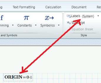

You're confusing
with
The first is the system variable ORIGIN, which defines the first/starting index for arrays (vectors and matrices).
The second is a(n ordinary) variable ORIGIN, which has NOTHING to do with array indexing.
If you want to define ORIGIN, you must ensure that the identifier is labelled correctly:

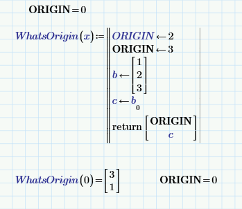

Apart from that, you are right to observe that the statement ORIGIN <- 1 (or whatever other value) does not work (as might be expected) in a program. See this:
Note that I use different font settings for the differently labelled items, because that makes life easier, and helps to prevent errors. My program demonstrates that even if ORIGIN is 3, I can still use index 0 for array b.
