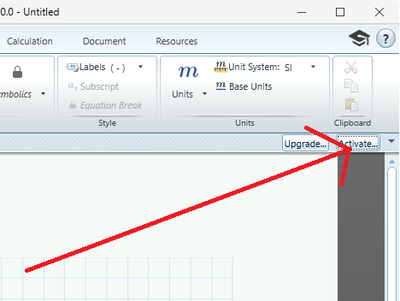

I have downloaded a trial edition of MathCAD prime 10. However it has defaulted to an express account and cannot use the prime features during the period. How is this resolved?

Select this button:
Then, with the "I want to try..." option already selected, click Next, and proceed as guided.
