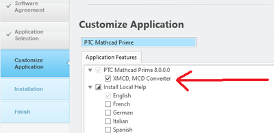

Rerun the Prime installation and in the "Customize Application' section be sure to tick the XMCD, MCD Converter feature.
