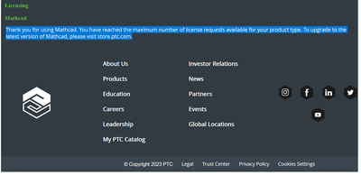

I purchased a student license for Mathcad prime 9 and have reinstalled windows. The License for my software is not working on my new PC. I require a new license to use the software I paid for.

This process yields the same result as before, the prompt just tells me I don't have enough licenses.
You can find the answer for this issue in the following thread earlier - "Reached the maximum number of license request": https://community.ptc.com/t5/Mathcad/Reached-the-maximum-number-of-license-request/td-p/704852
The link provided leads the the same screen as shown above. Will I need to charge back the product? I can't find any way to call support directly. I just need to use the product I purchased, and the website is bouncing me around the same 4 screens.

this issue has not been resolved, support is unresponsive and I'm considering a charge back.
You should request for a license manually by providing your Mathcad product code and physical address of Ethernet adapter using the following web case logger:
http://support.ptc.com/support/mathcad_supportCenterSingleUser.htm
The license file will be sent via E-mail.

Não funciona. Informa sempre a mesma coisa: "Thank you for using Mathcad. You have reached the maximum number of license requests available for your product type. To upgrade to the latest version of Mathcad, please visit store.ptc.com." Como resolver?
