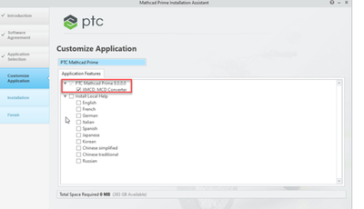

I just installed Prime 8.0 I'm trying to convert xmcd files but the converter button is grayed out under the input/output tab. How can I convert these files?
Todd
Reinstall - select the converter to be installed as below.
Full install details here https://community.ptc.com/t5/Mathcad-Installation/All-About-Mathcad-Software-Installation/m-p/706433#M26
