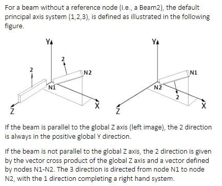

Here is how a commercial piece of software defines P on the y(2) axis.
In the graphic axis 3,2,1 is the same as your local coordinates x,y,z.
x(3) local is along the member.
y(2) local is defined as Y global for beams parallel to Z global axis.
y(2) is defined by vector product of Z and 3 if not parallel to Z global
z(1) completes the orthogonal set.
Define y(2) as above and you can set P for your example.

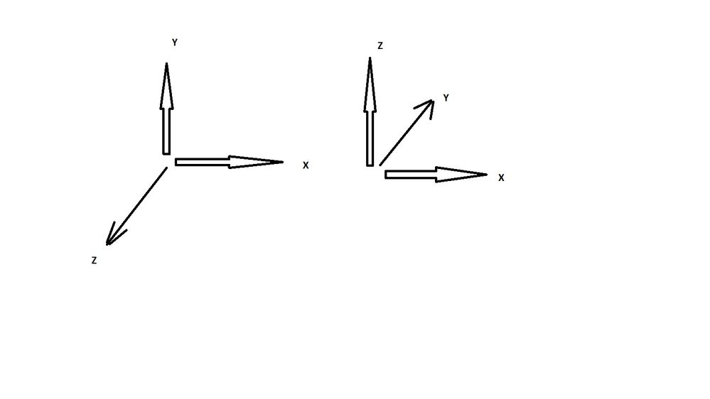

If I wanna my global Axis like below (XYZ) differ from example (XZY), what I should change to calculate P?
Described in your post a left handed axis.  Most software always deals with right hand set of axis.
A right hand set of axis can still have z vertical.
Here is a selection from 5 software packages all using right hand axis set.
My recommendation is to not use a left hand axis set.

I would use this(below) because all my sheet set (xyz) as global
With a right hand axis system with Z up the default calculation of P gives beams not typically in the correct orientation.  Works for columns.
You need to give either:- a reference node, rotate principal axis by 90 degrees, or
some software (not all) allow you to specify a global axis direction of P.  Here +Z would be chosen.

The default alignment works for any set of right handed axis these are both the same axis just viewed differently.
Right hand, thumb in x direction, index finger in y axis, palm points in direction of z axis.
Cheers
Terry
What you have drawn below is a left hand axis and the default does not work in it.
You do not need to change the default.
Only trying to help.

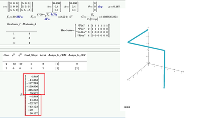

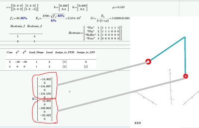

-Do not include Rotation transformation only (only translation transformation)
Case I: I got perfect solution compare to FEM
Case II: I got wrong solution (with horizontal vertical elements)
-Include Rotation transformation only (both transformation)
I got error when include Rotation transformation
I have attach Case II Mathcad and Case Include rotation
please correct me Terry
thank u

First thoughts are:
When you rotate the members remember the local axis changes.   This means the direction of applying the load changes.
Check that the direction is OK in your program.
Making head way.
Can you send me the file that does work for comparison.
