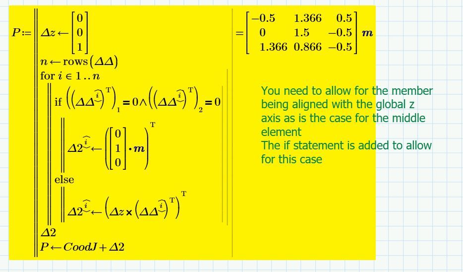

Dear All
Please help for calculating  Transformation of the nodal coordinates of the space
frame element, I stuck here both theory and Mathcad Prime.
I attached file of Mathcad prime sheet and lesson and example.
Best regards
SPRStructur
1 ACCEPTED SOLUTION
Have eliminated the error.
The case where the member aligns with the z axis needs to be taken into account.
Have added an if statement that defines this.
Cheers
Terry

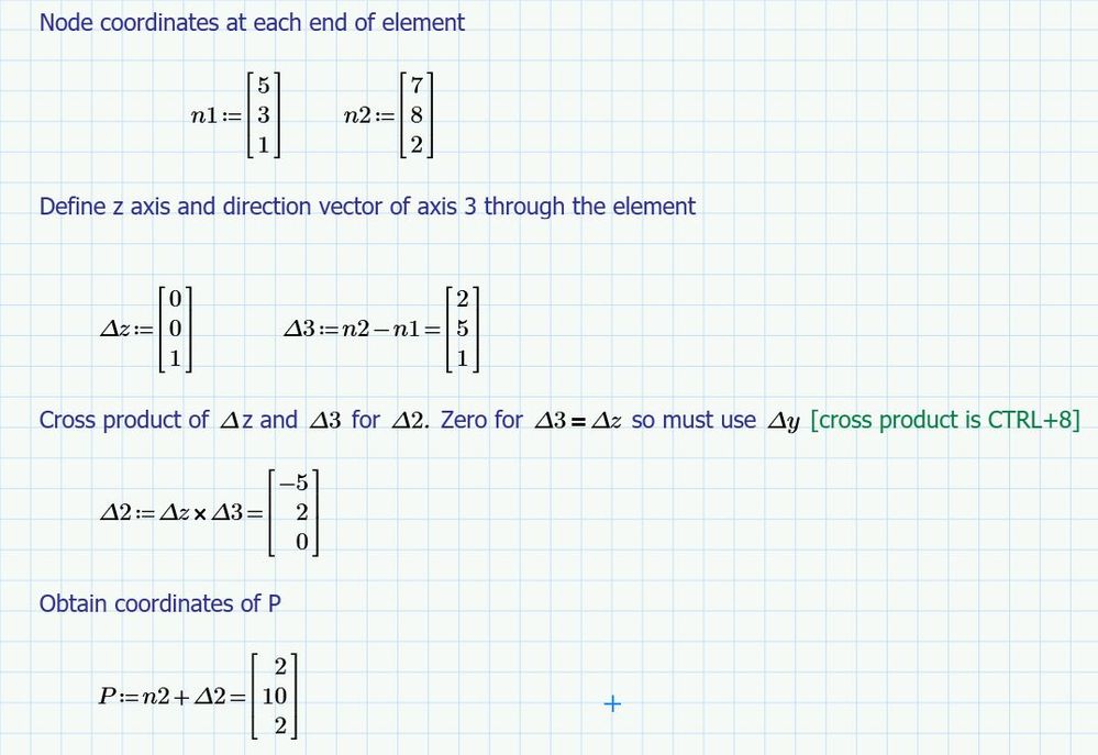

Here is how a commercial piece of software defines P on the y(2) axis.
In the graphic axis 3,2,1 is the same as your local coordinates x,y,z.
x(3) local is along the member.
y(2) local is defined as Y global for beams parallel to Z global axis.
y(2) is defined by vector product of Z and 3 if not parallel to Z global
z(1) completes the orthogonal set.
Define y(2) as above and you can set P for your example.
Cheers
Terry
Took time to show how to calculate P.
The case for element on z axis is trivial so not covered.
Cheers
Terry
Hello @terryhendicott
I got error when I apply my example
Cheers
Terry

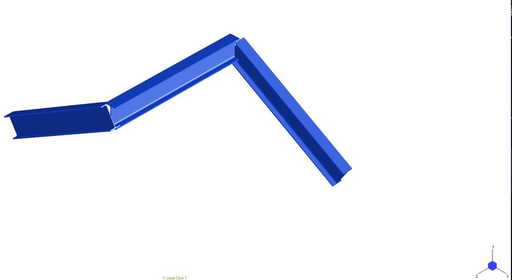

Frame element software usually has three ways to define local axis of a 3D member.
1) A default system.  The one you have done.  This is useful for building frames where the columns are all aligned.
2) A reference node for the position P of each member.  Here all axis point to the reference node in the center.  Like columns around a cylindrical silo.
If you look closely you can just see the yellow reference node at the center.
3) A rotation angle for the principle axis from the default system. P is rotated around the element 3 axis clockwise looking from node 1 to node 2 and specified by angle from 0 to 360

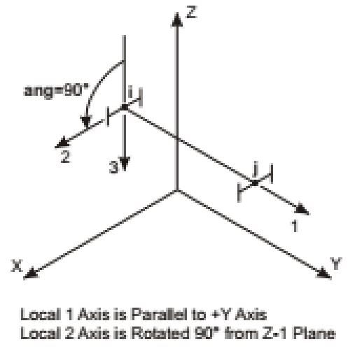

If I wanna my global Axis like below (XYZ) differ from example (XZY), what I should change to calculate P?
Described in your post a left handed axis.  Most software always deals with right hand set of axis.
A right hand set of axis can still have z vertical.
Here is a selection from 5 software packages all using right hand axis set.
My recommendation is to not use a left hand axis set.
Cheers
Terry
I would use this(below) because all my sheet set (xyz) as global
With a right hand axis system with Z up the default calculation of P gives beams not typically in the correct orientation.  Works for columns.
You need to give either:- a reference node, rotate principal axis by 90 degrees, or
some software (not all) allow you to specify a global axis direction of P.  Here +Z would be chosen.
Cheers

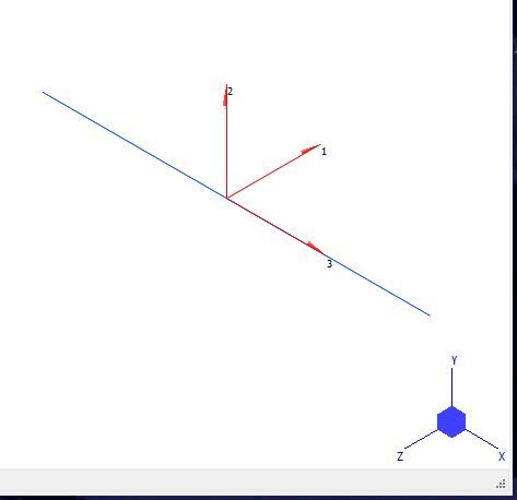

Even the labelling of axis of the element is different in different software packages.  Here is an example
What it seems you are talking about now is after the default orientation is determined an additional rotation is to be applied.  These angles of rotation are clockwise looking along the member.  Most finite element software has a capacity to do this.  Here you can use a Reference node or apply a rotation angle.

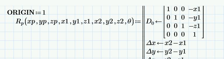

Here is function to rotate point P around an arbitrary axis. Along with default alignment this gives completely general alignment.
Point P is xp, yp, zp
Axis is x1, y1, z1 to x2, y2, z2
Theta is angle of rotation clockwise looking up the axis.

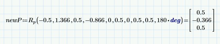

Here is function that gives a 180 degree turn to the first element in your example.
Cheers
Terry
