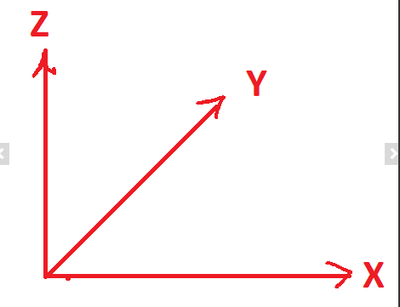

If I wanna my global Axis like below (XYZ) differ from example (XZY), what I should change to calculate P?
Described in your post a left handed axis. Most software always deals with right hand set of axis.
A right hand set of axis can still have z vertical.
Here is a selection from 5 software packages all using right hand axis set.
My recommendation is to not use a left hand axis set.
Cheers
Terry

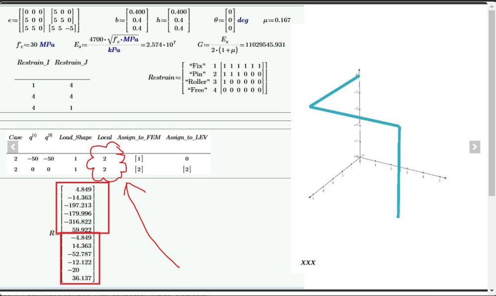

Hi.
The default method of determining P works for your problem.
Cheers
Terry

I think your sheet apply on XZY Axis only
not XYZ Axis
So I wanna change for XYZ Axis

What you have drawn below is a left hand axis and the default does not work in it.
You do not need to change the default.

-Do not include Rotation transformation only (only translation transformation)
Case I: I got perfect solution compare to FEM
Case II: I got wrong solution (with horizontal vertical elements)
-Include Rotation transformation only (both transformation)
I got error when include Rotation transformation
I have attach Case II Mathcad and Case Include rotation
please correct me Terry
thank u

Oh I forget specified you that Rotation Function I change a bit to fit my input so you can modified if you think it wrong. And I keep in mind Z is upward 👆 for input Elements coordination
Thank u

First thoughts are:
When you rotate the members remember the local axis changes. This means the direction of applying the load changes.
Check that the direction is OK in your program.
