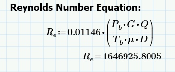

Mathcad Prime 7 n00b user here. I am trying to solve these two equations (pictured) by iteration without a previous value defined for Q but it is really stumping me. Currently I have Q defined but when it is undefined it really throws everything off and I am stuck. I will attach pictures and a file, feel free to edit as needed.

First of all--Mathcad understands units, USE THEM!
Second, did you really mean million cubic feet per hour?
Because if I put that thru a six inch pipe, it's going really fast:
Third, your equation for Reynold's Number doesn't balance:
File attached.

I tired using a for loop but I cannot seem to get it to work.
File attached.
