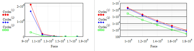

Dear all,
I'm facing again a problem with linear 2D interpolation.
In this case I tried to see if the results of direct and inverse interpolation coincide.
z=f(x,y) and y=f(x,z).
Unfortunately, they don't.
Could you please help me in finding the solution of this problem?
Attached you see the mathcad file.
Thank-you very much for your support.
Regards.
Enrico

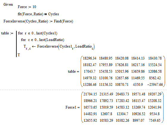

(To:ebelmonte)
I just looked at the top of your new sheet and compared the "inverse function" you provide (Force1) with the inverse values we can calculate from the given data (Force, Cycles, LoadRatio) using a solve block to provide the inverse function.
Some values are similar, some are quite off. So its no surprise that you don't get the same results.
Dear Werner,
Why are there value which do not correspond?
Is that due to the fit function you use to provide the inverse function?
below you find the function.
In the direct function I calculate the "N" while in the inverse function I calculate sigma.
The tables from excel are correct. Why shouldn't not work with mathcad?
Thank-you very much for your support!

Dear Werner,
The data sets stem from the same function. You can prove it observing the two excel tables I've copied on the right side of the mathcad sheet.
Below the answers to your questions:
"log" means logarithm to base 10 as in Mathcad?  Yes
sigma is Force in your sheet, Yes
N is Cycles, Yes
k is LoadRatio ? No, each column of the table "direct function" is a S-N curve obtained for one specific load ratio.
The load ratio is defined as (Fmin/Fmax). "k" is the slope of the S-N line and changes with the load ratio.
Whats the value of sigma.A? SigmaA is the force corresponding to 1000 cycles and varies for each load ratio.
I need the interpolation to get the function N=f(Force,LoadRatio).
The equation I wrote down indicates the relation between Force and Cycles: Cycles=f(Force).
(To:ebelmonte)
OK, I was asking because I was curious if i would be able to calculate and so verify the data tables you provided myself. But obviously I don't have enough information to do so.
I have looked at your Excel table pictures and I noticed that the red underlaid values fit pretty well, but the yellow ones don't!
With Ratio=0,8 and Force=10000, the first table shows cycles=285792
With Ratio=0,8 and Force=10926, the second table shows cycles=100000
This discrepancy may be possible, but may also be a sign the the data tables don't match up.
I can't tell as I am not able to recalculate the data in your two tables.
So the reason for the values not being the same may either  be an error in one or both of your data tables, or it can be because your data values are too far apart and linear interpolation is not appropriate - can't decide.
BTW, you write that k is the slope of one column in your first data table but when I look at hos curves, they don't seem to be perfect straight lines with a constant slope - not in linear, nor in log scale:
If you have a way to calculate k for a given Ratio, wouldn't it be simply
Dear Werner,
The discrepancies are possible since a low variation of the stress can lead to a big variation of the number of cycles.
The S-N curves are linear if x- and y-axis are logarithmic.
I think that the data are too much apart from each other for linear interpolation.
I tried also the following interpolation
which is working better for low number of cycles but poor for high number of cycles.
Do you have any idea how I can deal with this issue?
Thank-you very much!
