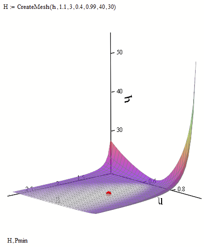

I am unable to create a 3D area diagram for the function h(a,u) defined in the attached file (MC14). Please help me.
Sunday greetings, Alfred Flaßhaar
Solved! Go to Solution.
The equation u=cos(a x) has no effect, neither have the ranges a and u you define.
u=1 has to be avoided because of the term ln(sqrt((1-u^2)/u) (-> minus infinity).

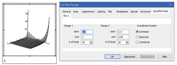

You could simply plot h, but you will have to manually edit the ranges for the input variables so that the calculation does not fail for any grid point.
Its more convenient to use the "CreateMesh" function and plot the created nested arrays

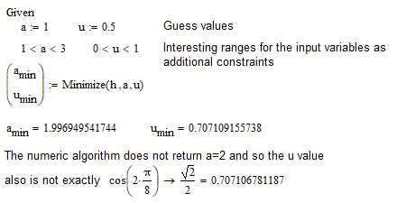

You could also create an array with values corresponding to the range variables you had defined and look for it minimum value
or you could use "minimize" to find the minimum
The values found do not exactly match the solution you name.

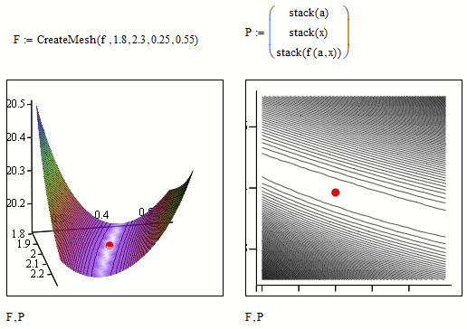

BTW, using CreateMesh its not to difficult to "zoom in" for better clarity.
You may also define the function as its given originally.
I don't think that Mathcad is capable enough to provide an exact symbolical solution, but we can get a numerical one either by using "minimize"

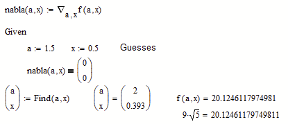

or by using the Nabla operator and a solve block with "Find"
The auxiliary function "nabla" was necessary because using the built-in function directly did not work.
