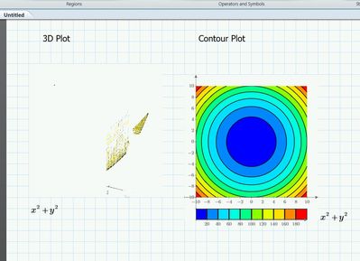

Hi Folks,
I'm trying to do 3D plots in Prime 7 to show my students.  The contour plots appear correct on the screen, but the 3D plots (surface plots) don't.  They look OK when I save to PDF, though.  Any idea what I'm doing wrong?  PDF and screen shot are attached.
Also, only the quick plot function seems to do 3D plots.  Am I missing something?  3D plotting in V15 worked at least as well as this.
Mark

Have you already tried updating the drivers for your graphics device?
??? Do you want to say that a structure created by a function like "CreateMesh" does not work OK?
You may want to attach a demo sheet which shows the error and does not work on your side.

This is a new machine and I assumed the drivers were up to date.  I'll talk with IT tomorrow about an update.  it's unlikely that I have permission to update drivers myself.

Hi Werner,
I just got done updating my laptop and the problem remains.  For now, I'll just use Prime on my desktop machine, where it seems to work alright.  Sorry I don't have better news.
I'd like to go back to V15, since I know it works.  However, the license doesn't support it anymore.

One of the solutions for Windows 10 graphics card issue that they recommend to use: https://support.microsoft.com/en-us/windows/update-drivers-manually-in-windows-ec62f46c-ff14-c91d-eead-d7126dc1f7b6

Thanks for the suggestion.  However, I just checked and the display driver is up to date.  I had a Teams call with someone from PTC this morning and they are working on it.  They tried some setting changes in Windows, but they didn't work either.  They got some diagnostic info and are trying to trace the problem.

Thank you for sharing the details of the situation with us. What video card model are you using?
mfrench
(To:VladimirN)
Hi Vladimir,
Thanks for the quick reply.  It's a Dell Latitude 5530 laptop and the display adapter is listed as Intel iris Xe Graphics.  I assume it's whatever graphics chip set they've stuck on the mother board.

Could you provide a worksheet where such an issue occurs?
mfrench
(To:VladimirN)
Hi Vladimir,
Here is a screen shot and the .mcdx file.  It's just a 3D plot of z=x^2 + y^2
As I mentioned earlier, this file works fine on my desktop machine, but not on my laptop.

sometimes it is necessary to use old drivers. This trick can solve your problem, too.
Example:
  • my notebook contains Intel UHD Graphics 620
  • I use Creo Parametric
  • I had to install old drivers ... 27.20.100.9466 released on 30.03.2021
  • I also had to disable automatic update of drivers
  • with current driver version Creo does not display appearance palette correctly

Prime 7 shows this 3D plot for x^2+y^2.
mfrench
(To:ttokoro)
Thanks for checking.  3D plots work on a different computer, so I think WernerE might be right - screen driver might need an update.
