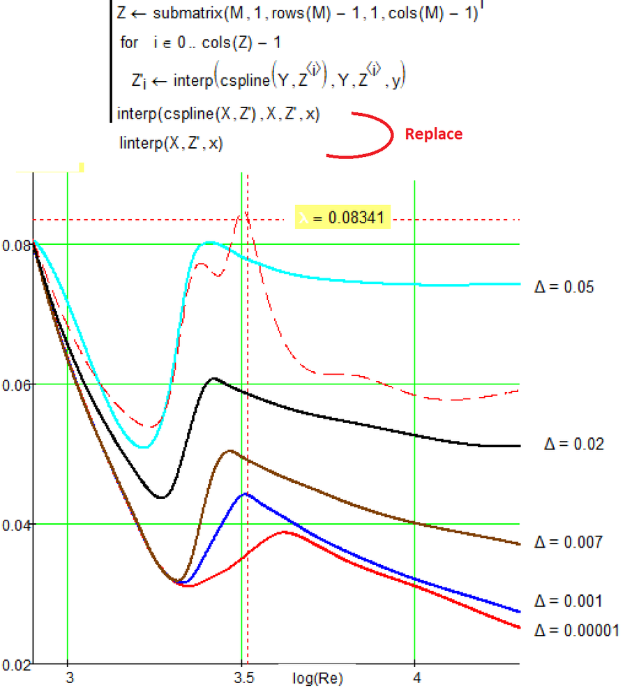

But my method is more unuversal!
I can use spline (rows) and linterp (columns) for the special data
One example
friction(Delta, Re)

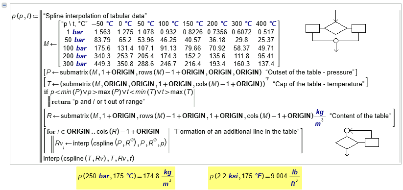

Really? Personally I prefer generic, universal functions as mine as I don't want to change anything in them in the future when I use them. Thats the reason I don't like the data and units inside that function. But ist good the both of us are happy with our ways of doing our things 😉
One example
friction(Delta, Re)
Hmm, I could't think of the need for using two different interpolations in the two directions. Of course my routines could be changed that way but if I would see the need for it I guees I would create a function with two additionals arguments specifying the interpolation types.

Sometimes you can avoid oscillations with spline interpolation if you use lspline instead of cspline.
But of course linear interpolation avoids oscillations completely but may have other indesired effects.
Replace two operators - and no accilation!
