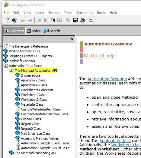

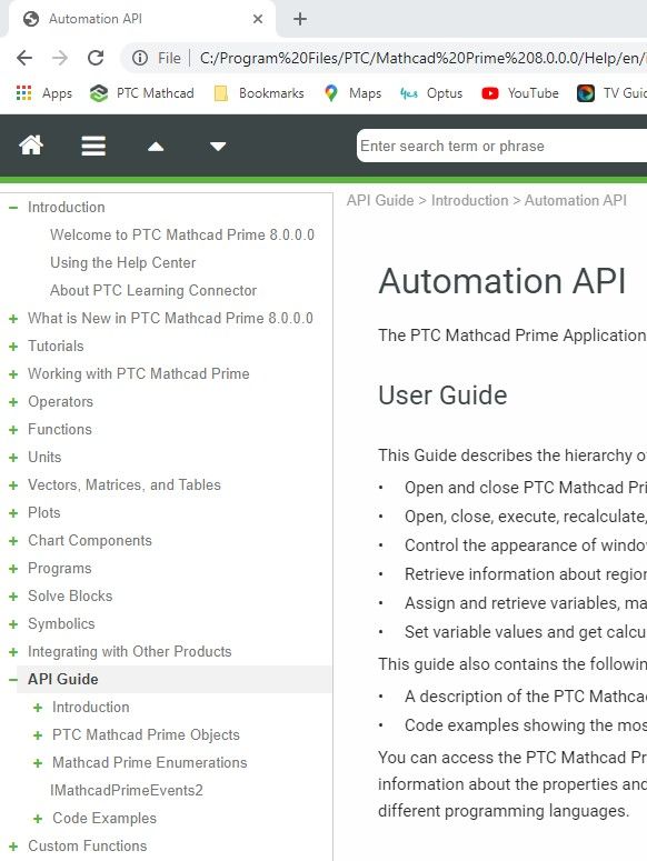

By Mathcad do you mean Prime or Mathcad 15?
In Prime you can find API documentation and Examples in the help files.
In Mathcad 15 they are in the developers reference.

1) I was just wondering if there are any official documentation for the API? VBScript and VBA are very similar, but they are still quite different.
The information on the API in the help file is as far as I know the only documentation!
2) Enclosed are two more examples.
