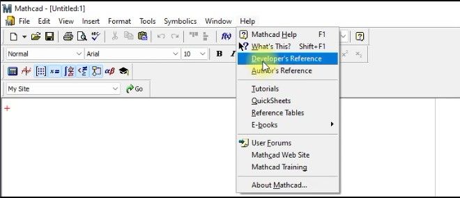

By Mathcad do you mean Prime or Mathcad 15?
In Prime you can find API documentation and Examples in the help files.
In Mathcad 15 they are in the developers reference.

Hi Terry,
Thank you very much! I saw this link and went through it already. However, I was just wondering if there are any official documentation for the API? VBScript and VBA are very similar, but they are still quite different. I did finished a simple program using VBA and because it was a very simple, I was able to guess through some of the function/method. But then, a more complicate project would require more than just me guessing through commands. I did looked up the library in the VBA, but all were just saying what values the function is taking in but doesn't say what the function do.

1) I was just wondering if there are any official documentation for the API? VBScript and VBA are very similar, but they are still quite different.
The information on the API in the help file is as far as I know the only documentation!
2) Enclosed are two more examples.
